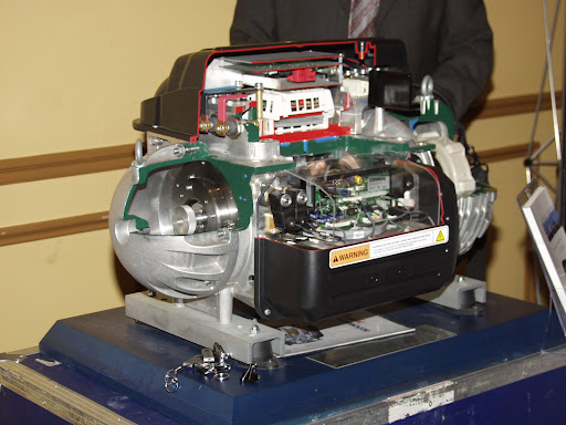

Re: turbocor retrofit
pretty cool huh!!!
after the entire retrofit you could replace one of those compressors by yourself in 4 hours!!!!!!!!!!!!!!!!!!
hmm!!
good point!!!
although the retrofit involves alot of piping!!!!
we charged 160k each for a retro and we just did 2!
plus they fail all the time like 100 percent in the first year so we can change alot of them!
and get lots of hours!
then when everybody figures they are junk they will pay us to put back in recips!!!!
turbocor is a wheel!!!!!!!!!!!!!!!!!!!!
2 stage centrifugal with inlet guide vanes and all!!
for velocity reasons and other reasons you repipe the entire job and add electronic expansion valves!!!!!!!!!!!!!!!!
lot a work!!!!!
they do not make a low pressure one yet but an instructor told me they are working on it!!!!!!!!!!!!!

hey frankie, slow down!!!!!!!
first off, whose machine was bastardized? a 19xr or a yk? (almost looks like a 19 e series)
i see in your pic that each compressor has 2 copper lines (suction and hot gas) you mention they are 2 stage. is there an economiser? i see in your pic new compressors mounted on an existing shell. you mention exv's. how do you rework the original shell design? original orifice? (i don't think your condenser had a float box.) i assume all the oil piping has been eliminated
i don't see the extra piping you mention........... sounds like an interesting retro.
you are looking at oiless compressors.
centrifugal kinetic displacement vapor compression compressor
NO OIL!!!!!!!!!!
the bearing is a magnet and the rotor shaft is magnetized the opposite of the so called bearing so it is frictionless>
or something like that
i am sure i am pretty close
